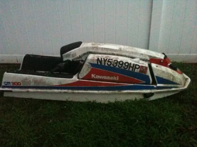

I just picked up a 1987 Kawasaki JS300 locally for $100. The hull is sitting in my yard and the engine is in my garage. I plan on doing a full ground up rebuild. I am going to try to keep a photo log and update this as I make progress. Also, does anyone have any suggestions for this rebuild or have any experience doing one? Thanks!

Took a scrub brush and some water mixed with a little degreaser/general cleaner to her today for about 2.5 hours. Doesn't even look like the same machine anymore. Still need to compound out some spots but the gel coat held up amazingly, no cracks only a few scratches from the previous owner.

111 Posts
that's a good looking hull you got to start with. I'm surprised how well it cleaned up.
I like that old Jeep Wagoneer in the background too.
