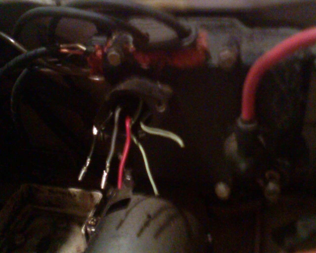

im building a js650 kitski. for those of you who arent familiar with my terminology. im taking and original js model jetski (440) and replacing the engine with a 650 out of a 1991 sitdown kawasaki jetski. if any of you will notice my other forum i did run into a slight hangup. im trying to mate a 440 cdi box with the 650 need to know what colors match with the others and cant find any electrical diagrams.... thanks for any help if u have it. i will have pictures of the new paint going on the ski as soon as it makes it on there. :)

i have 5 wires to splice. there are the 2 yellow and 1 black. but theres a black/red and a black/grey also.
and the 440 cdi has 5 wires going in. all solid colors. 2 green, 1 black, 1 grey, 1 red.
that picture doesnt help me too much. i think i need original wiring diagrams cuz i cant see where the wires are going or where theyre coming from....
heres the pics of the engine and cdi box if that helps explain what im talking about
See less See more
be smart , pick up 650 electronics box on ebay they cdi power curve has to match the engine or it will burn up the motor up. With a 650 e-box out of any 650 everything will just plug together, simple.
