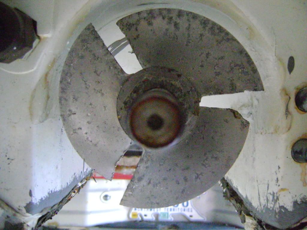

Picked up a tin boat the other day which someone had hacked a kawi jetski pump into, driven by a sled engine. upon research i discovered the donor jetski was an 87 js300.
Anyways, the thing was pretty sluggish in the water, partly due to a POS sled engine thats on there and partly because of a beat up pump.

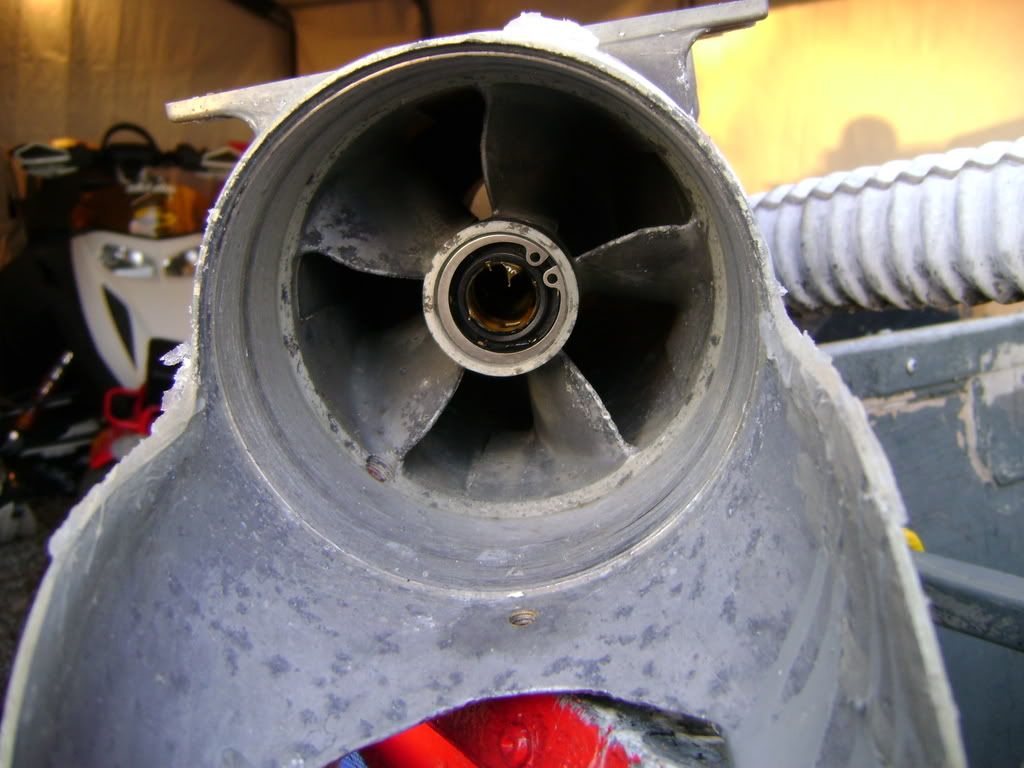

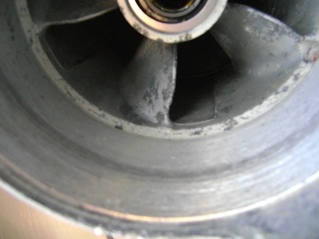

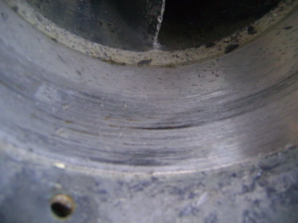

Heres a few pics of it tore apart. It appears the impeller took the blunt of the damage, the housing has some minor scarring but nothing huge.
Im thinking of just cleaning up the impeller with a die grinder for now (cant get it much more out of balance than it is now) and throw it back together and try to get the motor running better or a different one on there to see if the pump is even going to do the job.

Anyways, that impeller definately wasnt doing very good... I cleaned it up with the die grinder and its a whole different machine now. It can actually get the boat up on step with 2 guys in it!
