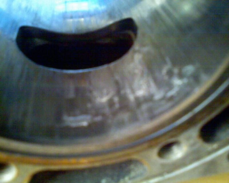

ok well i bought my first jet ski the other day i take it out for the second time and it looses compression in on of the triple cylinders and fucked shit up.
so i tear it apart and find this
it looks like it siezed up possibly due to lack of lubrication, and such but idk, i build cars not pwc's
i know i need a new piston and such but i want to know what caused this. can anyone point me in the right direction.?
as far as the lubrication system goes in these pwc's i dont know how they work either.
From the little I know about PWC it is good to add some 2 stroke oil to the fuel when topping up, also check the oil level before each ride...remember these two srokes burns oil rapidly.
