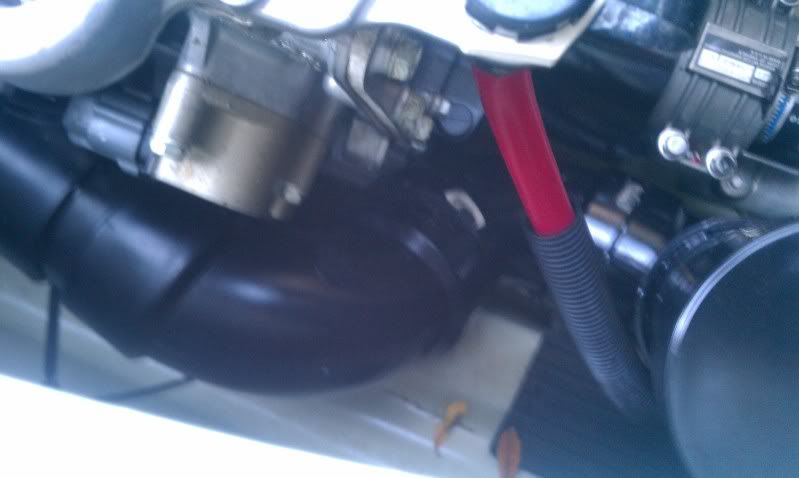

here are the pics of the intake, the mesh in the intake manifold, and a very poor quality shot of the exhaust, witch sounds amazing, but is almost a bit too loud

here are a couple more shots of the exhaust and a quick vid of a start up, but it was done with my phone so i dont know if the sound quality will be there

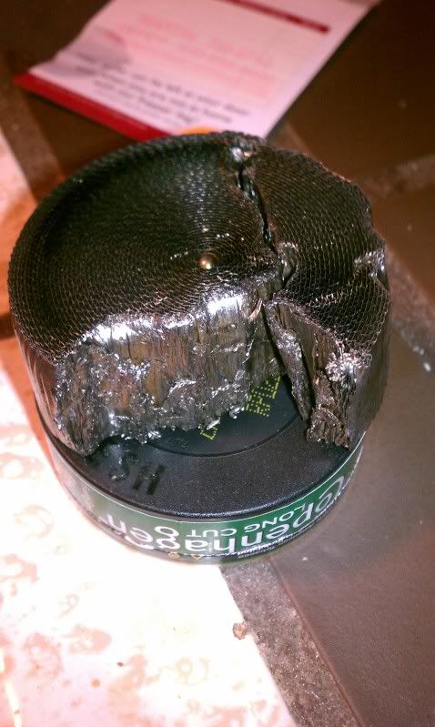

finally got all that nasty stuff outa the intake, all the rest of the parts should be here by tomarow, but leaving for ohio in the morning and wont be back untill friday, hapefull have everything installed on friday and tested friday or saterday, and report back, here is the pic of what i removed from the intake, and the open intake
How did you get this (i think it's called the ribbon) out from the piece it's attached to?

basically i used a small chisel, hammered it thru till i got that small piece off, then i was able to roll the rest of it out, do not attempt this with the manifold installed! it is very easy to take off but you will get metal piceses in the engine if you dont remove it.
